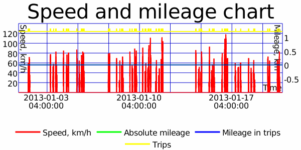

Also there is “Speed and mileage chart” in the report. You can get its image using the request get_result_chart. To place a chart name above the chart, set the flag 0×01, and to place a legend under the chart, set the flag 0x200 (512).
https://hst-api.pro.transcontrol.ru/wialon/ajax.html?svc=report/get_result_chart& params={ "attachmentIndex":0, "action":0, "width":600, "height":300, "autoScaleY":0, "pixelFrom":0, "pixelTo":300, "flags":513 }&sid=<your_sid>
Response:
